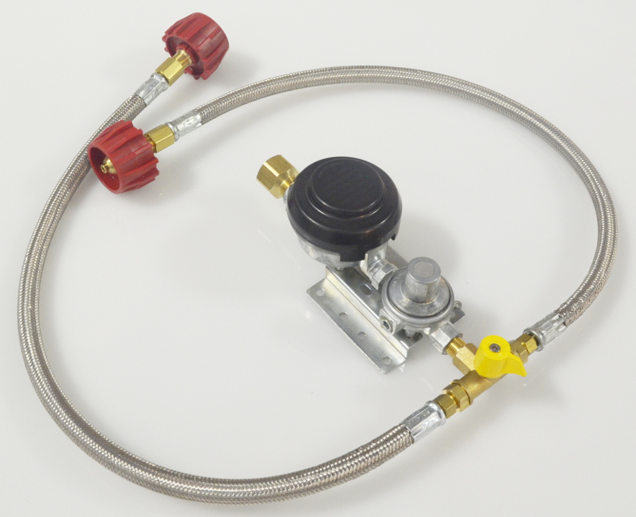

  • How about something like this. Looks like it's a single regulator with a T-valve and hoses going to each tank. This is something you could do yourself, and have 100% control over which tank is on. And its definitely not "automatic switchover"
    Web site where this came from: Click here.
