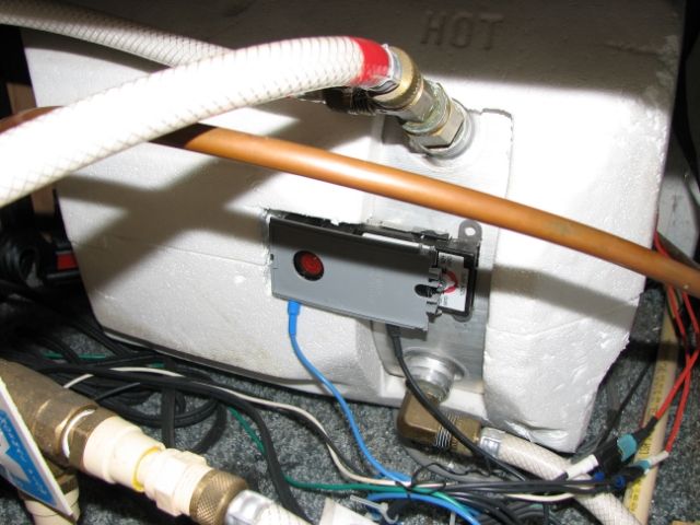

    This is how I mounted the T-Stat from the Camco Hybrid Kit to the rear of my water heater tank. You need to remove some of the Styrofoam and there is some very sincere adhesive tape pre-attached to the T-Stat. The instruction sheet is too miserable to post. It's an easier job than the sheet would have you believe.
