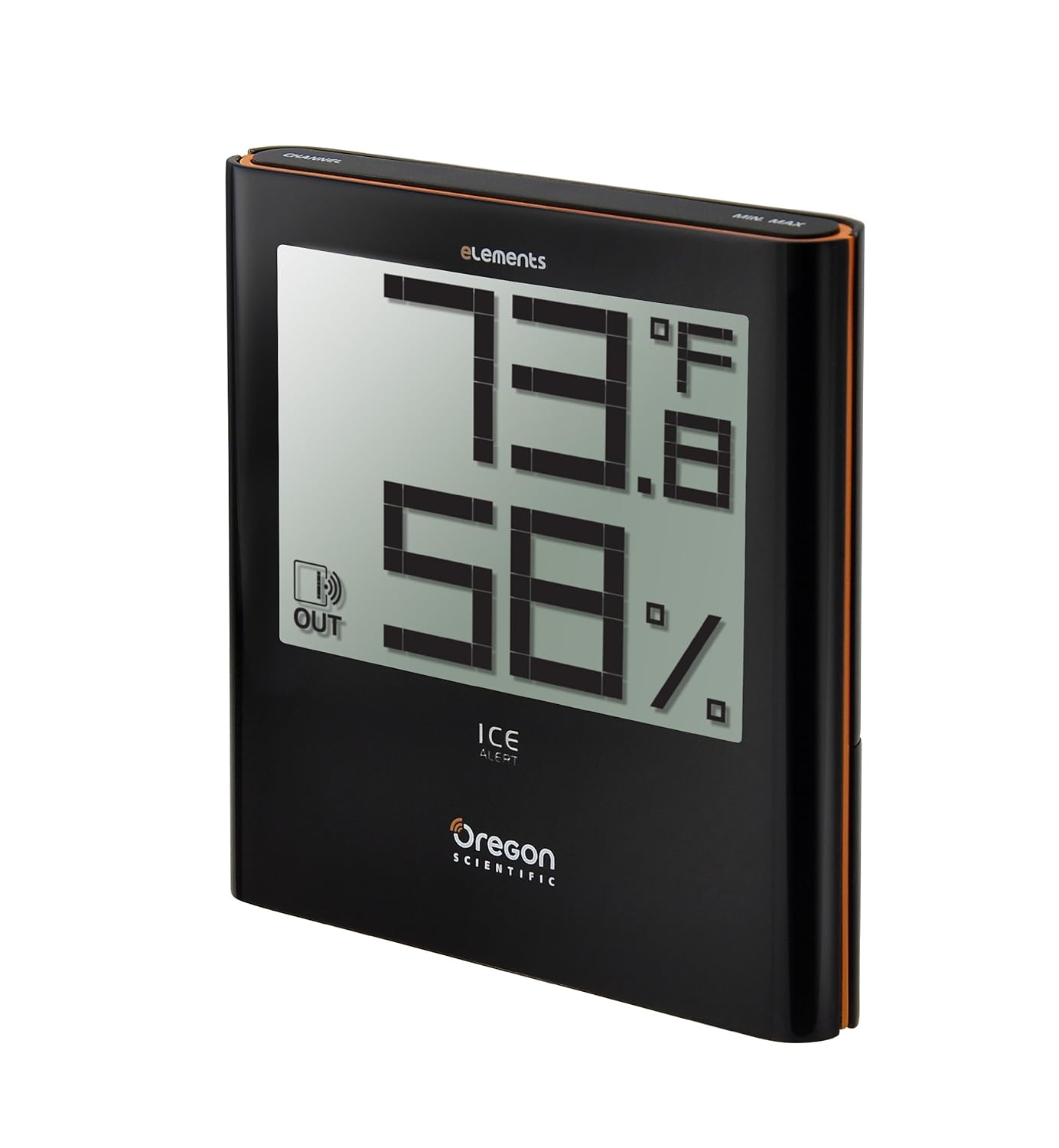

You need a 2nd opinion. Get an indoor thermometer (something like the one below) and place it in the RV, where the heat isn't directly blowing on it. If the tstat is actually in a bad location for accurately reporting the temperature then the other thermometer will help show what offset is needed to achieve the desired temp.
