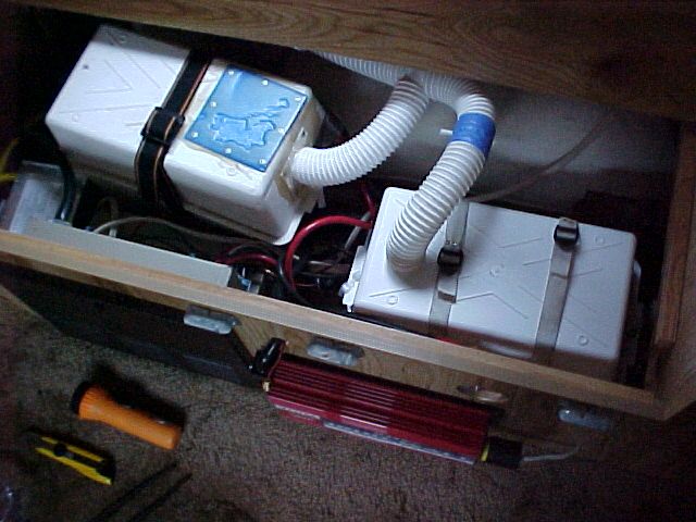

    My fifth wheel has a battery VENT to the upper right hand side of the front access door. I have two vented battery boxes sharing this one vent hole that looks similar to this google images photo. I got my venting hardware and tubing from LOWES...
    My two battery boxes sits down in the recessed area just behind the front access door. I also drilled some fluid drain holes to drain out thru the floor of the storage compartment in case my converter/charger boils out some battery fluids from over charging... Looks similar to this google image...
    If I was going to mount four batteries in this area I would go with something like this install I have seen on google images. You can see the vent tube in the upper right hand area of this photo. The top shown below seals off the wooden box used in this google images to house the four GC2 batteries sitting end to end...

  • My Bats. are inside so I vent them to the outside. I had to modify one of my boxes.">clicky
