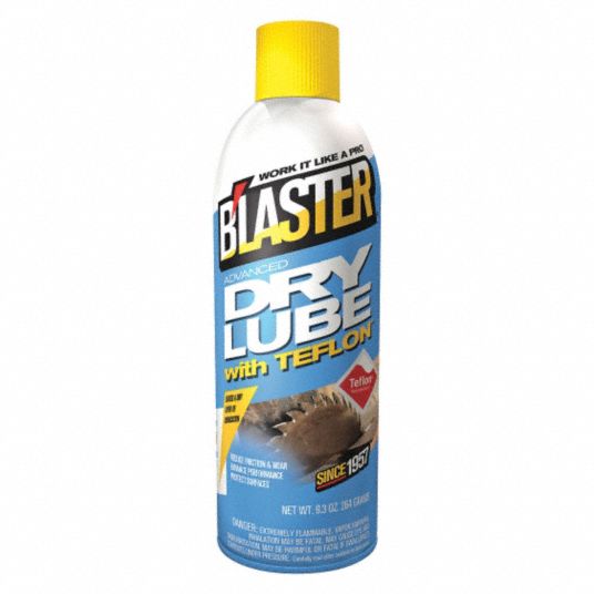

For me WD40 is good to remove grease off something if i have no other degreaser choice. Or applied to drywall knifes or a hand tool that accidentally got wet. Or the old standup jetski manual sure has you spray that stuff everywhere. It literally says to coat the entire engine. But i only spray it into that hole where i think the stator lives. Oh and the distributor cap of an old vw engine!! (lastly maybe for cologne) - BurbManExplorer IIIWe did a lot of beach camping with the TT and the sand gets everywhere. Rule #1: NO grease, WD40, or other oily lubricants, they become sand magnets and once the sand sticks to the oil/grease, whatever you tried to lube will grind itself to death. I use a teflon "dry lube" spray on the jacks, steps, etc.
You can buy this at the major home centers and hardware stores:
