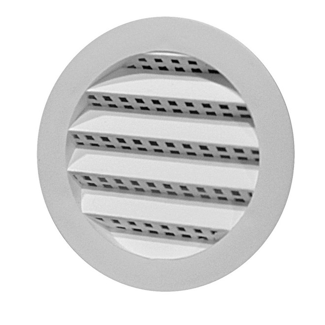

  • There is at least one brand of exterior vent intended for battery venting. I installed one on a previous TT. It has a mating piece on the inside for connecting a standard 1-3/4" battery vent hose. Not sure what brand(s) these are - Valterra, MTS products, JR Products, etc. I bought our vent & hose at a local RV dealer. The one in this photo is on ebay:
  • DrewE wrote:
    #1 looks more rain resistant to me, though it may be a matter of the angle of the picture. I would likely choose it for that reason and drill a little weep hole at the very bottom of the vent so any water that gets in has a place to drip out.
    That's a great idea, I will put a couple of holes on that bottom row.

    What type of vent should I install on the sidewall of the camper?
    I looked at what is being sold as a "battery box vent" and I have found 2 models that look a lot like them, which one would you suggest?
