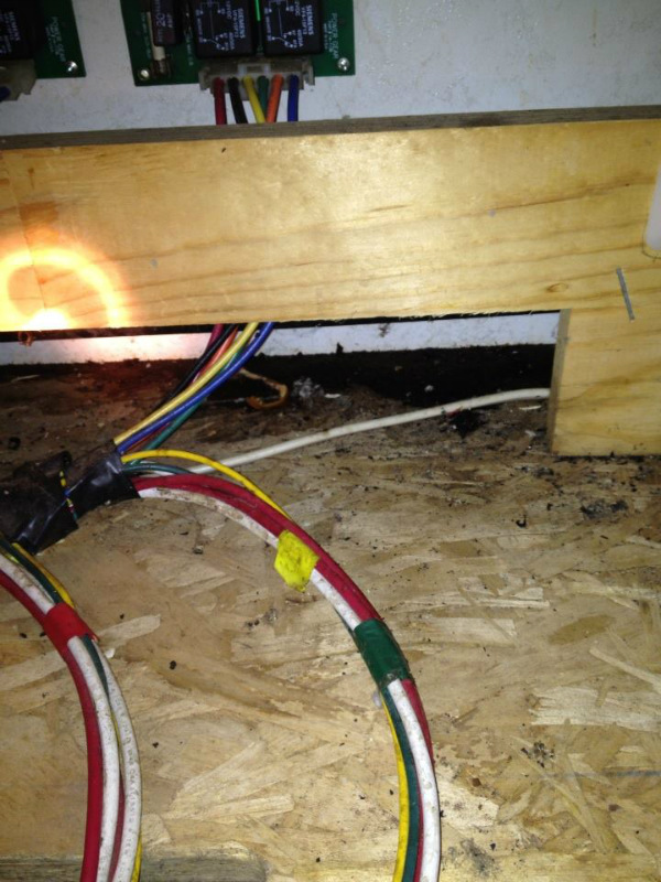

I see some moisture, about 1-3" on the kitchen floor behind the drawers, by the outer wall. This pic was taken below the oven. I think cranking up the oven tomorrow might help dry that out. That or the infrared heater. ?
It feels like damp dust. No odor at all. - FisherguyExplorerYa, better than fiberglass, if it was fiberglass the whole wall cavity would be soaked.
