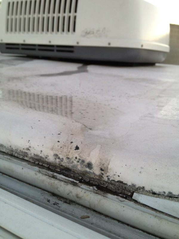

- mark5wExplorerIt will be difficult to get the substrate dry behind the filon wall. Sometimes a water activated glue like Gorilla glue will stick or a marine epoxy like PC 11. Don't plan on getting it flat.

gravity rarely moves water upward. :B - cannesdoExplorerYeah, no, it's the roof. Knew it was time to get that caulk redone. No evidence of anything around or under the window, just the laminate problem. Big evidence on the roof and down below the rig -- directly below -- on the cement. Seems like if I open it up and dry it out and then seal it up, it should be ok. ? It's the A/C water. It's an Alpenlite Stonecreek 5'er.
- RVUSAExplorerYou have to seal the leak with the correct caulking, not silicone.
You can repair the bulge by draining it (small hole near the bottom of the bulge) then filling it with epoxy (small hole near the top of the bulge and a syringe) then pulling a vacuum on the area to force the bulge back flat or clamping like these guys do.
http://www.pplmotorhomes.com/parts/caulks-sealants/delam-repair-kit.htm - FisherguyExplorerIf it was the windows the problem would be under the window.
What make RV is this BTW? (Just curios) - cannesdoExplorerOh no...ohhhh no. It's the water from the AC. It's running to that one spot and when I scrubbed the roof edges last week when I cleaned the roof I must have opened up a leak. Water is running down inside. And just tonight, out the bottom -- a very very slow drip. How do I dry out the inside of the wall. Is it me or does that look like black mold? They can't open it up, can they? I'm thinking all you can do is dry it out well and then reseal it. ?

Any input would be appreciated. If I take the window out I figure I might have a better sense of how bad it is. Might be able to dry it out better with a blow dryer or something. ? - cannesdoExplorerOk, thanks! Any recommendations for the stuff that goes around the vents etc...on the roof? Or how to get the old stuff off? And how to strip the old stuff off the edge of the roof? The rubber on the roof has been checked and is ok for now.
