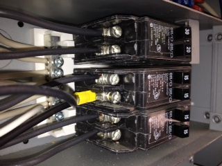

  • Doesn't look like you have any room to add another breaker.
    The suggestion to add a separate switch, once you find the wire, may be your only option.

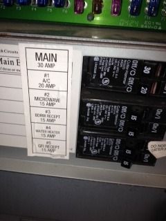

  • All breakers have just one wire except the Bedroom receptacles, which is indeed #3
    I guess I have to go deeper...
    Will test first as suggested.
  • I traced the lead from the converter back to the breaker, and found that it shared the breaker with another wire. Dunno what it was. Replaced the breaker with a double 15A and separated the leads.
  • Most likely #3 or #5
    Turn one off while on shore power and check charging with a multi meter
    You might loose use of some receptacles you want

  • This is the panel:
    All I can get at is the breakers and fuses. Any other connections are hidden.
  • Sounds like it. They're usually on their own breaker, or share with something like the fridge, but it sounds like more rewiring is in your future.
  • I don't think you have to pull it out. Find its 120v feed.
