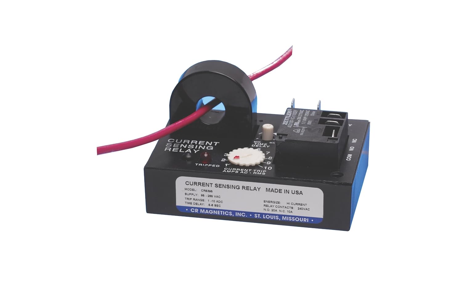

You can buy an automatic load shedding device but aren't cheap.  You could make your own up by using a CR Magnetics current sensing relay like in the photo, available on Amazon under $100.  Wire the A/C circuit through the sensor and the hair dryer circuit to it so it can't run with AC unit on.  Could also wire up to prevent an appliance in the kitchen from running.  May not be too practical if AC is running a lot and voltage is low tho.
