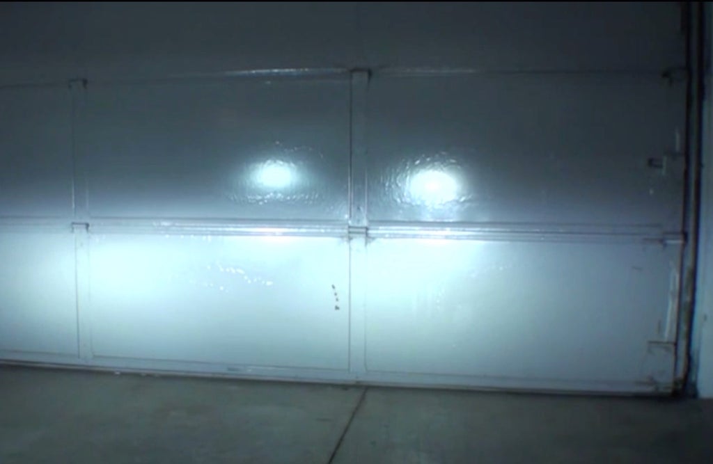

Found a pix on line ..
Left is halogen bulb and right is a LED bulb..
Notice how focused the Halogen is when compared to the LED..
The LED is not focused well and has a lot of scatter, that scatter is the problem with using LEDS, might be "good" for the driver of the car with the LED but not so much for the poor sap that has to drive past or even be in front of that car..

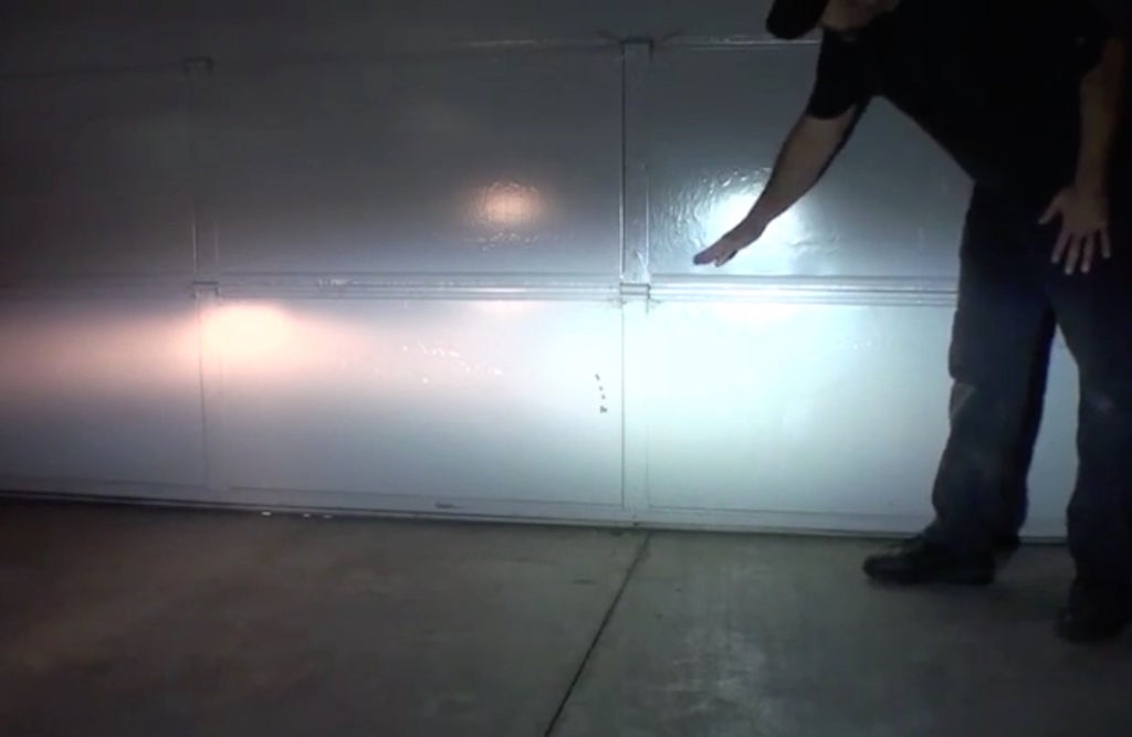

Here is a pix from the same site that shows both LEDs..
Notice how much more light is scattered on the drivers side into the oncoming traffic..
Found those pix HERE Which they are using non clockable LEDS..

An example of the issue with retrofiting a LED into a halogen housing is really telling..
