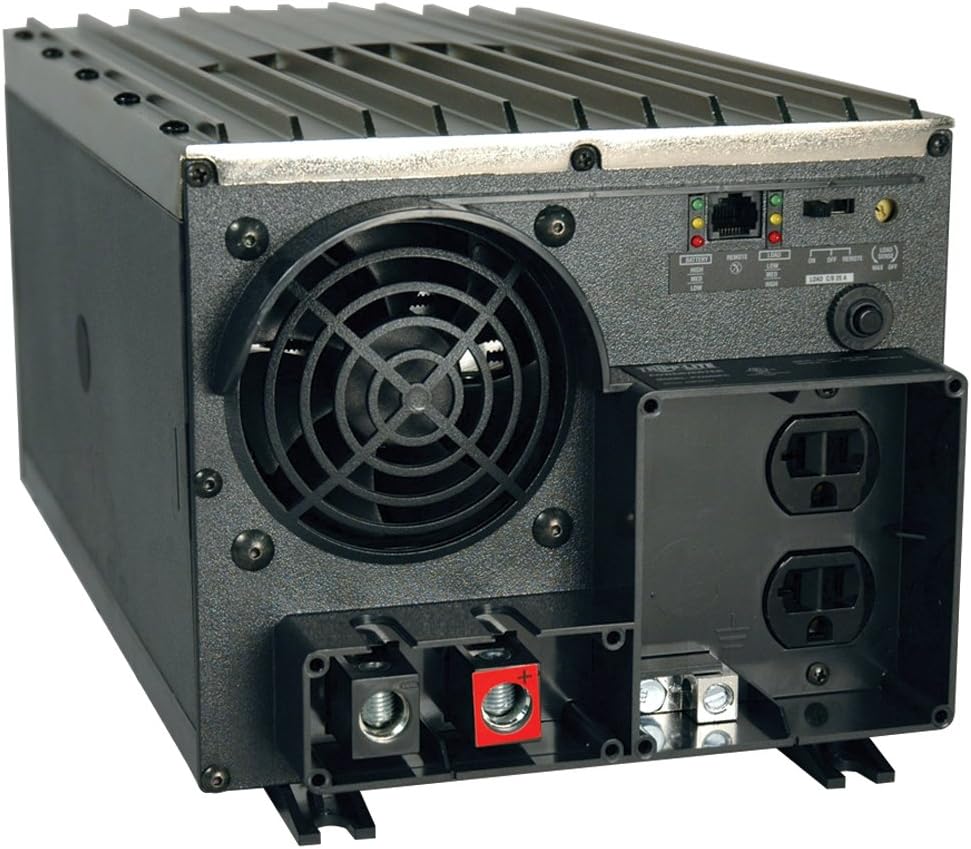

If you are really serious, skip the cheapos, spend a few more nickles and go with Tripplite Inverters.
Mainly in your case, Tripp Lite Power Industrial Inverter PV2000FC
With 4,000W Surge, they do not come cheap at $400 but it WILL outperform any other MSW out there.
This inverter is built ground up to handle heavy inductive motor startup loads. I have the smaller cousin PV1250FC to run my home fridge conversion and it handles that perfectly fine, fridge starts and runs quietly.
PV2000FC At AMAZON
2000W Continuous
4,000W Surge DoubleBoost Feature
Tripp Lite Inverters deliver up to twice their nameplate rated wattage for up to 10 seconds, providing the extra power needed to cold start heavy-duty tools and equipment. This is the ONLY inverter that I am aware of that can handle twice the rated power for TEN SECONDS, most inverters only handle the surge for MICROSECONDS!
OverPower Feature
Tripp Lite Inverters deliver up to 150% of their name plate rated wattage for up to 1 hour, providing plenty of reserve power to reliably support tools and equipment longer. (3000W in the case of PV2000FC)
Manual
HEREWith this amount of surge current, you WILL NEED to use the MAX wire gauge that will fit the terminals which is 2/0 and keep the 12V wiring as short as possible!
I should also add, this inverter IS remote capable, you can buy an optional remote to turn the inverter on/off plus it has status info on the battery and inverter load. Pricy at around $120 for the remote, it allows you to mount the inverter as close as possible to the batteries.
This inverter also has a power save feature you can adjust which will automatically turn on/off with load demand which I use for my home fridge conversion to save battery Ahrs.
