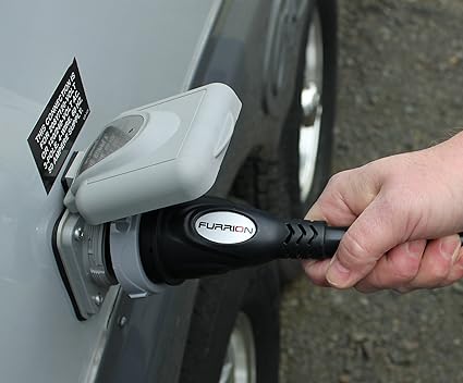

As others have stated this would be an excellent time to install an external shore power cable connection that uses a 30AMP Extension Cords with plugs on both ends...
Available from AMZON
Will look like something similar to this on the outside of your trailer when completed
