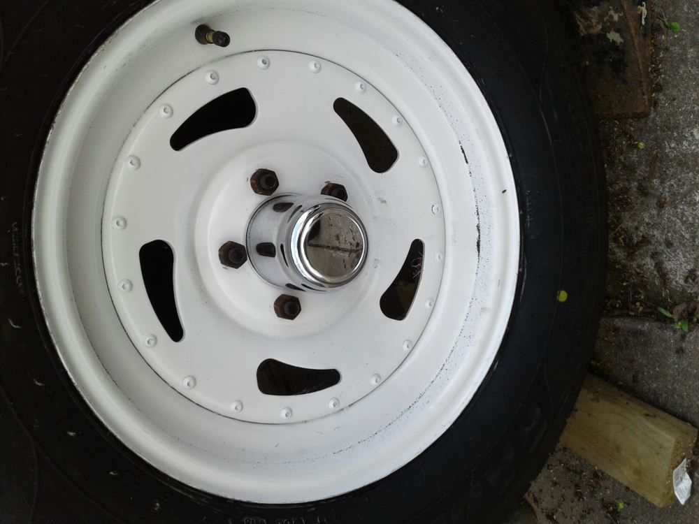

I have E-Z lube hubs, but the wheels have chrome hub covers that insert from the inside, which means that if I want to grease the hubs, I need to remove the tires. Has anyone replaced those hub cover inserts with something that facilitates the access to the lube zerts for the hubs?

    Mine has the EZ Lube axles, but the large chrome hub covers have round openings in the end that allow greasing the axles without removing the wheels or covers. Just remove the rubber plug and there is the zerk. Does yours not have the openings in the large chrome hub covers?
    My covers look similar to these or these.

  • You have the wrong parts, they should have a center that pops out. That said, I have no use for that way of greasing.
