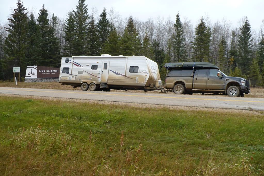

  • Bearhawk,
    Thanks for that info. And the picture.
    Yes I can see the difference. I wasn't too concerned about the squat on it as I could always adjust my hitch to ensure a level ride.
    Your F350 likely has about the same rear suspension as my 3500 does. And mine runs loaded with the rack and toolboxes 100% of the time too so an extra 140 pounds won't be a big deal for the truck itself.
    Now as for the factory GM hitch..... hmmmmm..
  • I have a similar setup. The "squat" was more pronounced after I added the batteries and I had to adjust the head of the WD hitch as the ears on the bars were digging into the head. I added air bags this year and it really levelled it out nicely. I have 3 group 31 12v's across the A-Frame in a rack welded to the top of the frame.
    Water in the back really did not seem to make a difference to my setup.
    Before Airbags added, but batteries on the frame can be seen. If you compare to the signature photo (before batteries) you can see the difference they made.
