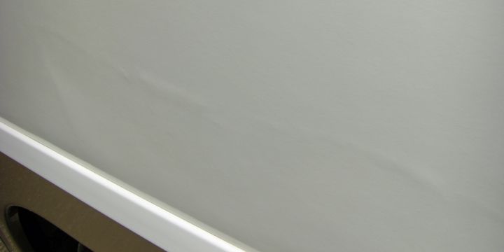

this is a 2006 winnebago. walls are made of their THERMO-PANEL SIDEWALLS which at that time suggested there was no wood involved.
anyway what is this ripple about 6 inches by 1 inch and what do we do about it?
the door panel is buckled too.
we have gone to extremes to make sure the roof is allways sealed and also the various openings in the walls.
thanks all
1 Reply
  • The ripples look like a classic case of delamination to me. The door looks warped. Both conditions are usually caused by moisture intrusion.
    Per materials in the sidewalls: there is luan plywood there, at least according to this description of "Thermo Panels" from this Winnebago link
    Winnebago wrote:
    Our Thermo-Panel sidewall and roof design pressure bonds the exterior skin, luan backing and EPS block foam to the walls’ aluminum framewor
    Good luck!
