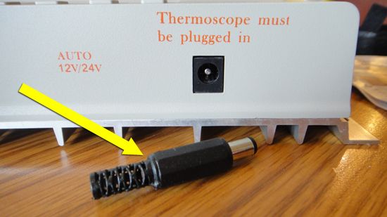

Have you tried it with an extension cable? - BFL13Explorer II

Yes it is the temperature sensor. Same as on my Solar30 controller. It goes in a hole in the top of the controller and sticks up like an antenna. It must be in there so it all works. (might explain the funny readings you posted earlier)
Don't lose that part! - pianotunaNomad IIIHi Mitch,
It may be a temperature probe that could be placed on the negative post of the battery. Of course, that would require adding a cable to extend the "reach". Plugging in at the controller is better than doing nada. - xzyHollyxyzExplorerOP HERE.
