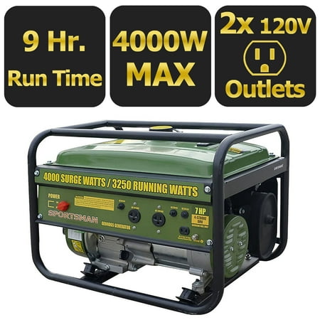

I have a Buffalo Tools 4Kw gen which is 120V ONLY that I use for my camping.. Not sure if they sell under that name anymore, seems to me they changed to "Sportsman" brand..
Looks like this..
Found that pix HERE but they are out of stock.. Too bad, cost is $293
There ARE other "brands" of the Chinese clone gens that are 120V only in non inverter setup, you simply NEED to do some detective work.
READ the information carefully, if it says 240/120 you NEED to stay clear of that one.
If it says 120V ONLY then you have a winner..
Just be aware, many of these Chinese Clones have very little warranty/parts support (same with HF, they don't carry or sell repair parts). You will be on your own if it breaks.
Thank you for this recommendation, found it for $229...awesome!
