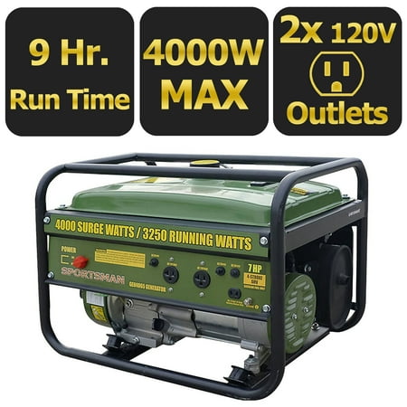

Looks like this..
Found that pix HERE but they are out of stock.. Too bad, cost is $293
There ARE other "brands" of the Chinese clone gens that are 120V only in non inverter setup, you simply NEED to do some detective work.
READ the information carefully, if it says 240/120 you NEED to stay clear of that one.
If it says 120V ONLY then you have a winner..

Thank you for this recommendation, found it for $229...awesome!
considering there are 2 ac breakers on that unit, he's pretty much going to be in the same boat as the generator he has now.
he needs a generator with a 30amp 120v outlet on it, to get full power from both windings. it has nothing to do with what voltage its putting out. No genny manufacture is going to put bigger then a 20 amp breaker on a nema15r
That is not the right picture, this is the one I got with 30 amp RV outlet.
https://www.homedepot.com/p/Sportsman-4-000-3-500-Watt-Gasoline-Powered-Portable-Generator-with-RV-Outlet-801187/206403560
