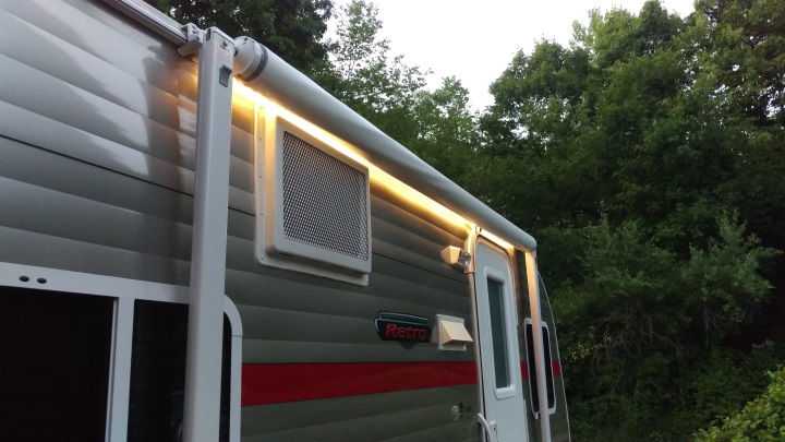

  • I added an RGBWW light strip to mine, and the WW seems WW. Always hard to tell because cameras try to white balance, but pic is below. Compare to the white trim and overcast sky. If I wanted it even more warm, I could use the RGB part to add more yellow/orange. The one I received has the soft urethane (silicone?) coating over the LEDs, not the silicone sleeve which some come with.
