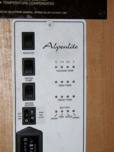

Had some time on my hands today and felt like farkling......
My new Honda EU2000i generator needed some "LOVE"....A fuel shut off was the order of the day!

    Draining these carb's before long term storage is the key to easy starting in the future… I did a similar mod on my 2K Honda, but added a 4-pin connector and wiring which gives me the flexibility to use the generator at home or shut down (and/or select 'Eco') from inside my camper.

  • Actually, you don't even need to install the "RUN" switch. Just disconnect the plug, turn the engine switch to "OFF" and let it run out of gas. Since you only need to do this for long term storage, it might be the way to go if you don't want to modify.
    If you left the plug disconnected, you would not have a way to shut the generator down quickly in an emergency. My generator will not "choke out" with the use of the choke. And cutting just the fuel, my generator will run for quite a few minutes before fuel starvation shuts it down.
    So if you disconnect the switch for long term storage fuel drain, reconnect it before you use the generator again............
