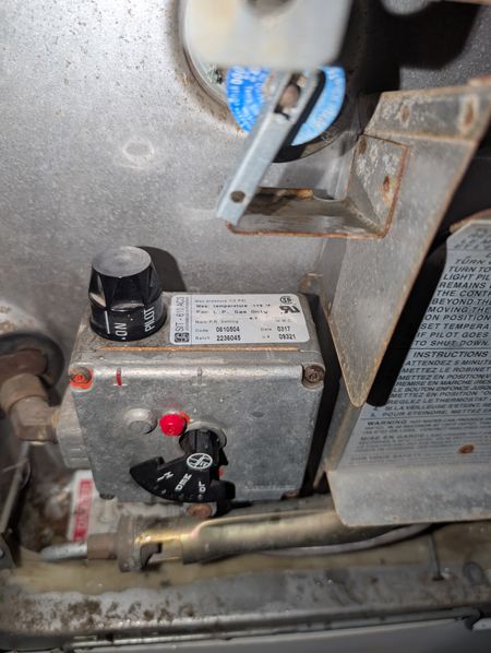

Only reducing the pressure (counterclockwise) on the SIT 610-AC3 helped resolve the issue.
From what I can tell, reducing the pressure with the adjuster causes the propane to be released more gradually and slowly.
Problem fix. This is how I did it:

should have posted a video of the flame to start with haha. It still doesn't look like a good hard flame, it should be all blue with little wisps of yellow on the fringe. maybe a tiny bit more yellow when the doors open, but when closed you should see the slightest amount of yellow on the tips, if your door has a sight glass.

The main thing that I wanted to show in the video is what screw you should play with the adjust the flow to the main burner.
I released the screw all the way (to reduce the pressure), and then had to turn it back in a little bit (as the pressure was too low).
In the video description there's a link to 2 more videos that show how I measured the pressure and the flame after I finished.
Obviously those are educational videos and not the official way to do it. I'm not an expert of course.

- StirCrazyAug 17, 2025Moderator
