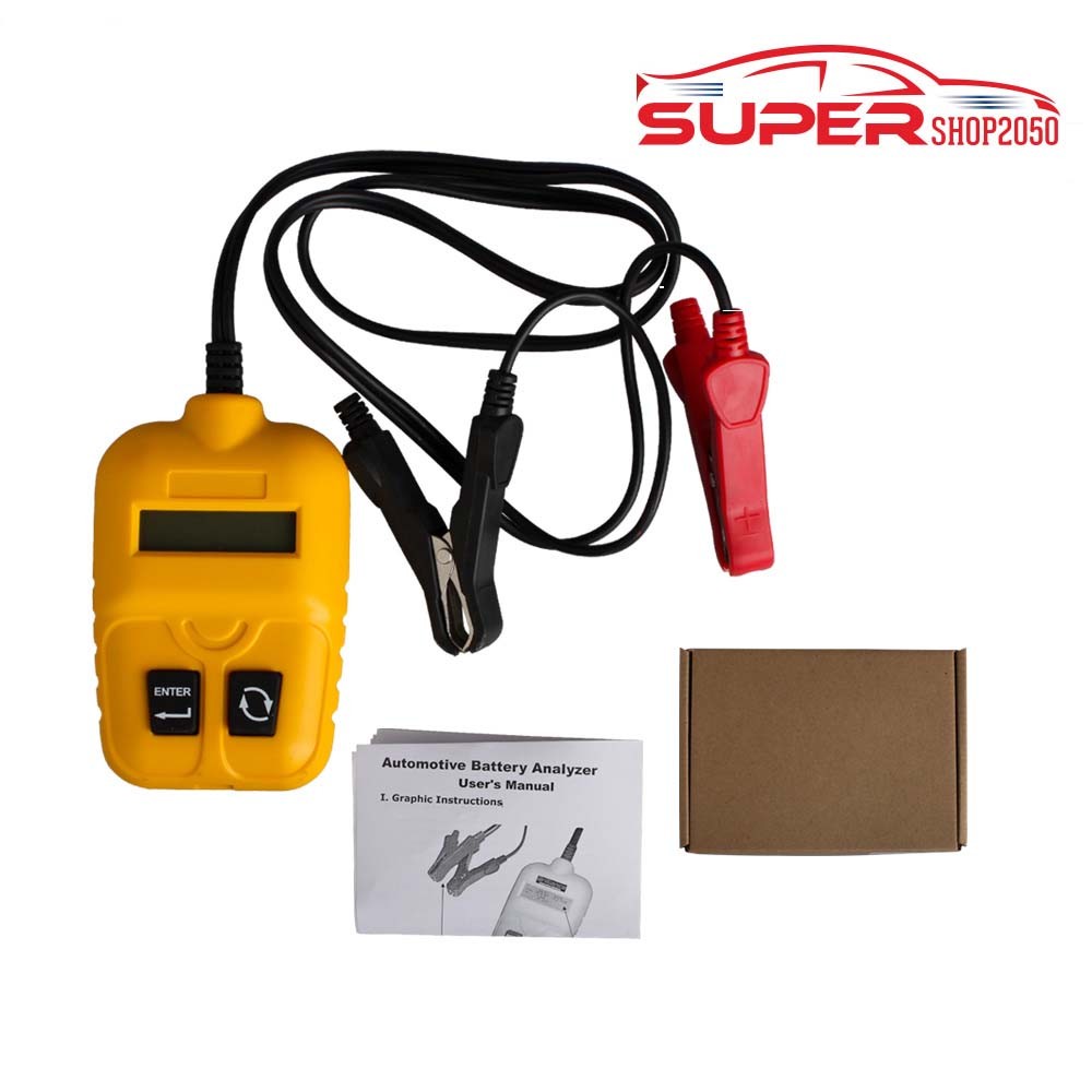

Impendance Tester For AGM Loss Of Capacity
If this little puppy works as advertised a person could test their AGM battery when new. Record the reading then down the road if they suspect the battery has lost capacity due to improper charging it would show up as a higher value impedance reading. For testing the battery would have to be fully charged and the test conducted at the same ambient temperature.
https://i.ebayimg.com/images/g/AysAAOSwaC9abuvA/s-l1600.jpg

  • Nice--but does it have a name? The link merely goes to the image.
