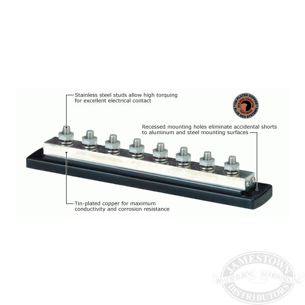

  • Is that 8 batteries in parallel? Going to need 600 amp bus bars to connect.
    Just need a 50 amp transfer switch. (50a RV assumed) Insert between existing TS and the main panel. Converter needs to be moved to get power from before the added switch.
