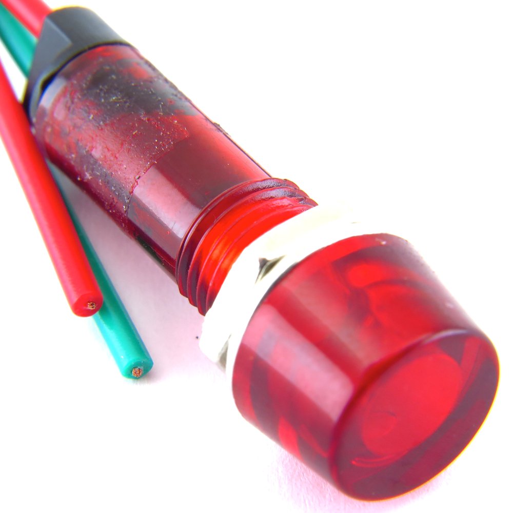

It's So Easy To Make Primitive LED Diagnostics
For announcing the presence or not of shore power. Wired across a 120vac circuit breaker to announce a tripped breaker...

  • AC power available at shore power relay
  • Generator power available at shore power relay inlet
  • Coach power available at shore/generator switch
  • Connect across 120 volt breaker. Indicates if breaker is shut off or has faulted due to tripping
  • Drill holes, push LED into hole then connect to screws.

  • The pictured item could be LED type but it could also be the old style neon indicator.
