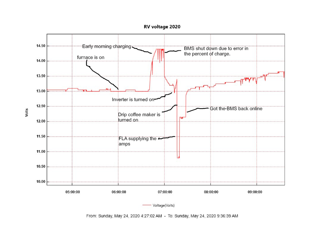

This is exactly why I went with a hybrid LFP-FLA system. Here is an voltage example of when the was a software SOC error. The LFP BMS shut down shortly after sun up charging started.
