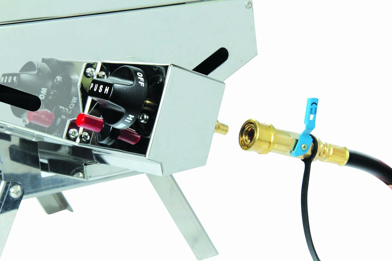

  • Thank you all for your input. Here is the description of the product:
    The Camco Olympian 5500 Stainless Steel Gas Grill is designed for RV and outdoor use. This high quality lightweight stainless steel barbecue has a large cooking area of 180 square inches. Its cast iron smoker plate is designed to offer the fullest flavor while minimizing grease fires. The stainless steel burner heats up faster, is easier to clean, and resists rust. The grill is quick and easy to assemble. It includes a quick-connect hose and valve to use the low pressure propane supply on an RV or trailer that has a built-in low pressure quick-connect propane connection. The Camco Quick-Connect x ACME propane hose (57629) or Quick-Connect x throwaway propane hose (57628) must be purchased separately to use the grill with a 20 lb propane cylinder or 1 lb throwaway propane cylinder.
    Pic of hose
    http://ecx.images-amazon.com/images/I/71euh%2B%2B0k-L._SL1500_.jpg
