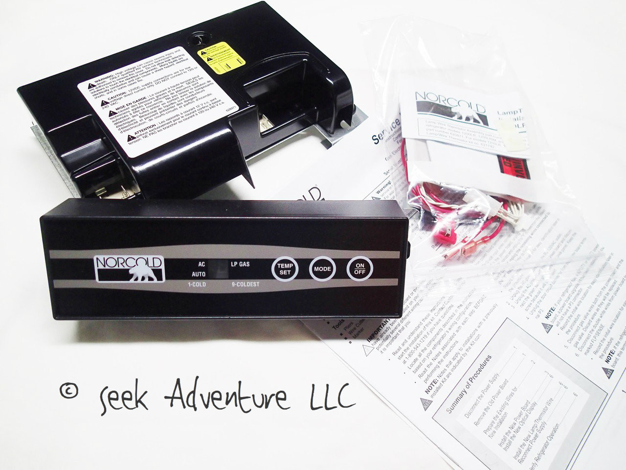

It appears your refrigerator automatically selects the source of heat for the boiler. The control board requires 12v in any case. 120v is selected if available (green). If not, switches to gas operation (amber). If neither source can be proved, it flashes the red indicator lamp. Seems pretty straight forward.
If you want to force the use of propane, you could unplug the cord in back if the refrigerator from the outside. That wouldn't make much sense because propane will always be more expensive to use than electric. The only reason I could see to pull the plug would be to save that amp or so of power if using a small generator or it you're tripping a too small breaker.
