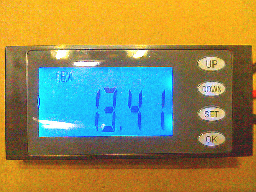

"Oh Look I Am Pasting This On The Front Of My HF Charger
Why? Well this is a digital ammeter good to fifty amperes. No biggee. OK, add on a halfway accurate voltmeter, something the HF and few other chargers have. BUT WAIT! THERE'S MORE!
This meter has kWh measurement capacity. Not kindergarten grade mere amp hours. It will display the amount of ENERGY that is delivered to the battery under charge. Total accumulated energy.
By using and keeping track of voltage baselines, and determining the amount of ENERGY needed to bring a sealed valve regulated battery back to full OEM at rest voltage, a person stands a chance of knowing the state of being of a valve regulated battery. Yeah this means an AGM battery. Not bad for 25 dollars.

    KWH is sure a valuable feature. On a device as powerful as HF, it won't even take a week to see the first kilowatt-hour proudly flowing in :)
    The "10A" HF charger has been clocked at 19A in the mid 13 volt range. That's about 250W. Your kWh is registered in that week minus about 6 days, 20 hours. :)
    Seriously though, energy meter of some kind is a useful thing with any charger. Energy measured in watt-hours is practical in residential applications, while kindergarten grade amp-hours is the lingo of choice in RV and automotive world.

    I do like the larger scale readout on Mex's meter

    OK where did you get this meter?
    Well... judging by the annotation in the upper left corner... I think I can guess where it was made, at least.
