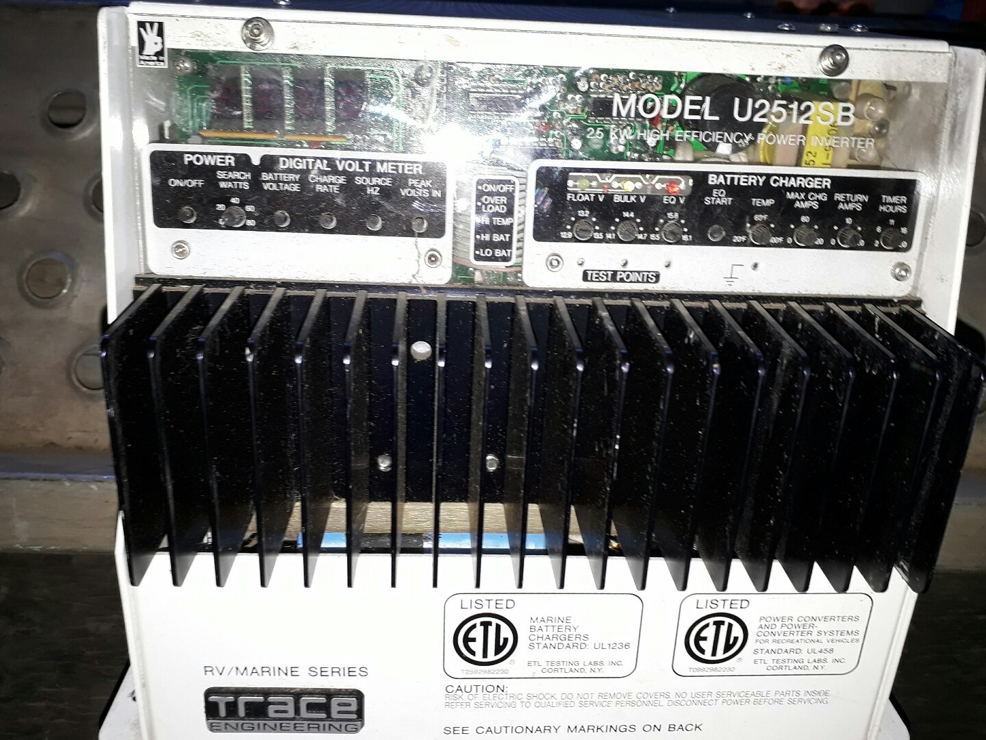

road-runner wrote:
Will 25 kW run my air conditioner
That's a good question!
However, probably this solar setup will run it: :B

- road-runnerExplorer IIIWill 25 kW run my air conditioner??? :)

Th smart camper takes one or two tried then remembers that running the charger for x-hours will fill the batteries completely. Too slow? Buy a bigger charger. I'll harp again -- this is NOT charging with an old fashioned transformer battery charger. This is charging with something that has an adjustable upper voltage charge voltage setting. All the freakin' difference in the world.
The Trace was a 120 amp charger. And had adjustable timing to limit time at maximum absorbsion voltage.
Wanna buy a THIRTY YEAR OLD pseudo sine wave charger. The one in the picture came from eBay. It was sold the same day for eleven hundred dollars. Neat huh?

MrWizard wrote:
why ? it only produces power when the sun is out
and 13.6v is not going to do the proper battery charge
Hmmm ... my error. I thought Mex's photo was merely of a good old Trace battery charger/inverter.
Hence I thought he was making a point - when using the Trace in it's charger mode - of it being capable of RV battery charging at a manually adjustable voltage and for a time interval set using an Intermatic mechanical timer ... his usual (and excellent) K.I.S.S. recommended method for good battery charging under tight user control.
If so, my point was that one could also not use the Intermatic timer, set the Trace to say, a fixed 13.6 volts, and then use it 24/7 in one's RV as a standard fixed voltage converter to power 12V items whan on hookups or a generator.
