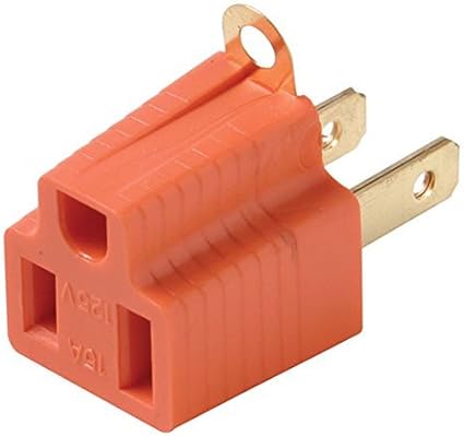

  • Some inverters do weird things with the neutral and ground. Try a two prong adapter like the one below:
