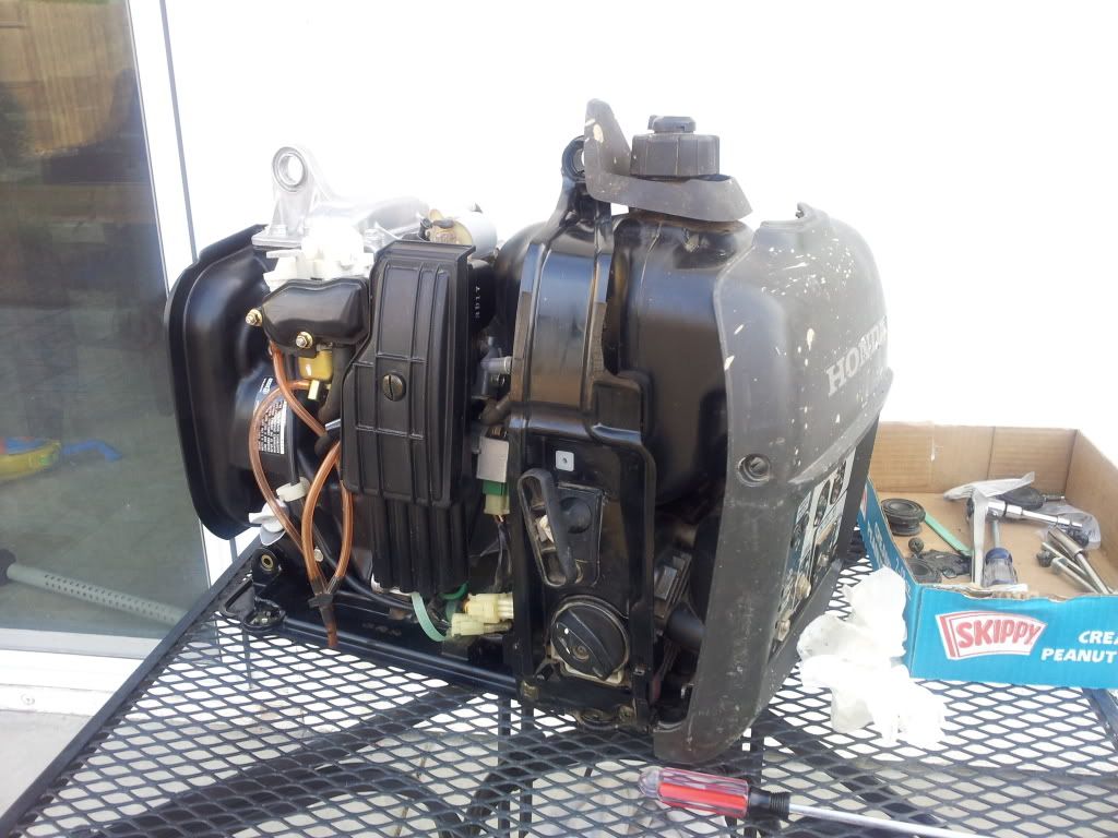

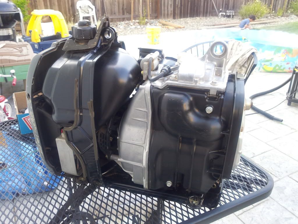

Taking the fairing off the EU2000i was pretty simple other than having a stripped screw I had to drill out of the handle. Two long 10mm bolts on bottom and the rest Phillips screws. I used a razor to take off all the decals which I tossed since they were beat to hell. Washed with dish soap and water to get off dirt and then wiped down with paint thinner to get off old adhesive and oils. Used Qtips to get the tight a areas.

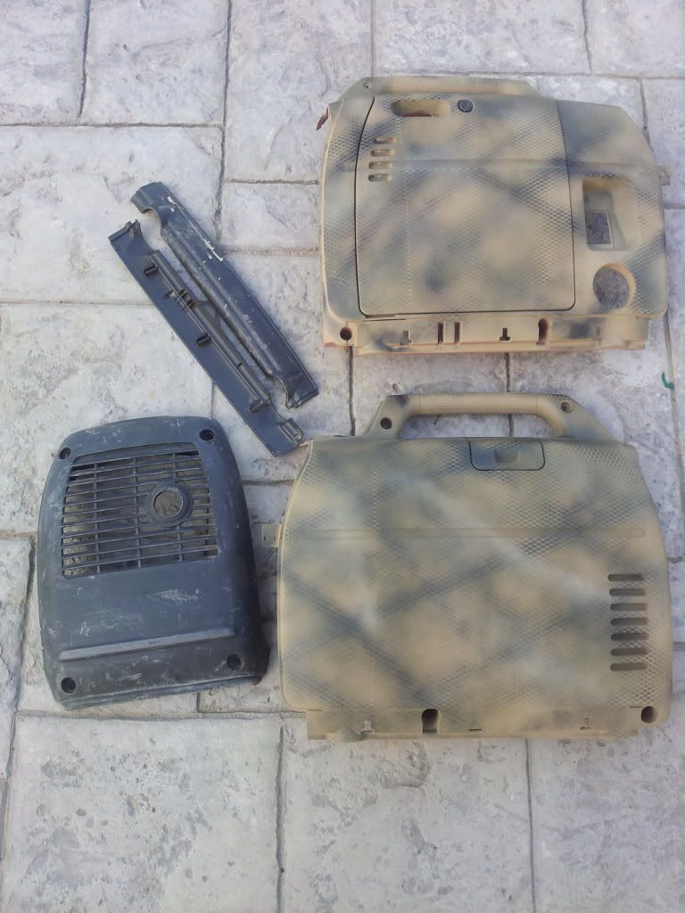

I started with the tan paint as a base. I wasn’t too sure about the brown paint I bought so I traded it for a High Temp BBQ flat black spray can I found in the garage. Then put the mesh down and sprayed the black followed by the green. Took off the mesh and thought the marks from the black were a little strong for my taste. Went back over with just a random dusting with the green and tan to soften it up.

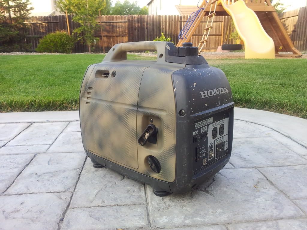

One thing I regret was attempting to sand the rash and dings out with 200 grit paper and kind of half bottomed it. I should of went over it again with something finer or just left it alone. When the paint went down on those areas it looked uneven. Ultimately it didn’t matter because uneven and inconsistent is what you want in Camo. Also I painted in about 100 degree heat. I think some of the paint dried before it hit the plastic. I think this is why I have a very rough texture after the paint dried. Sand paper like texture. I topped off the paint with a clear matte Krylon for some added protection.

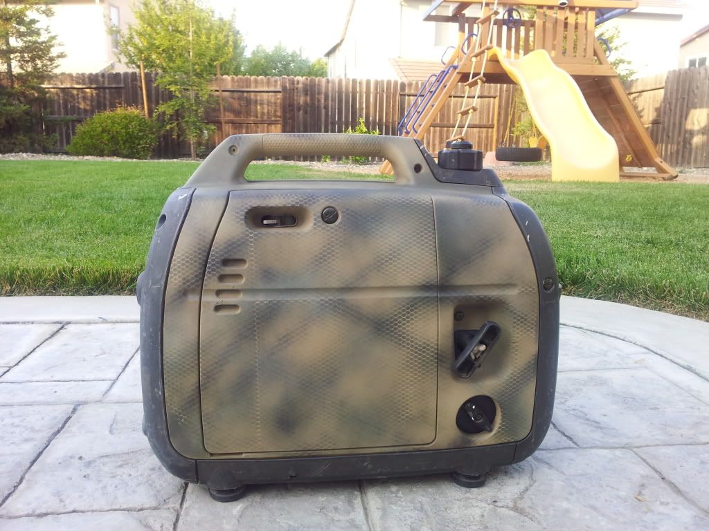

Overall I am pleased with the outcome as this was my first attempt at a camo paint job. Now thinking of painting my other EU2000i to match. Or maybe more of a forest camo for when I’m in the mountains. This one can be my coast/beach unit.

    Why didn't you paint the black part?? What you painted looks good, just unfinished...
    Yea I though about it. But thought I would just copy Honda's Camo edition. Plus I ran out of tan paint. Ha!
