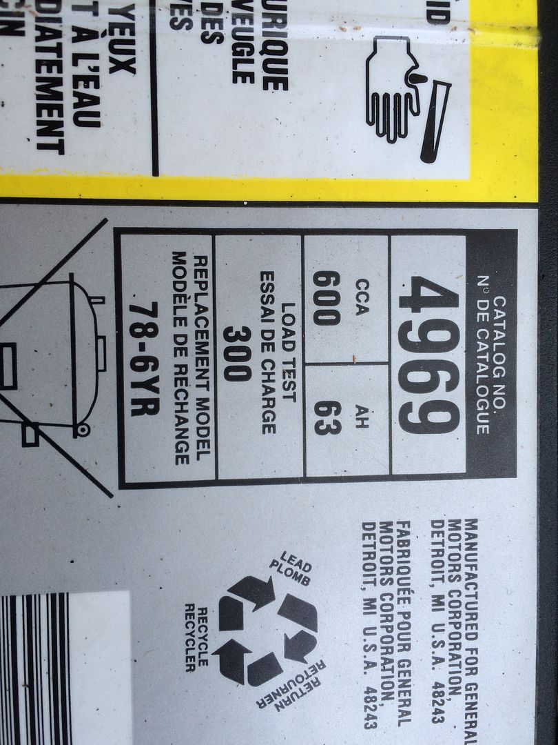

They had an AC delco 600 CCA batt in there. Funny the starting batt is the same but a 770 cca batt.
Both these batts state 63 ah on the label which is weird...

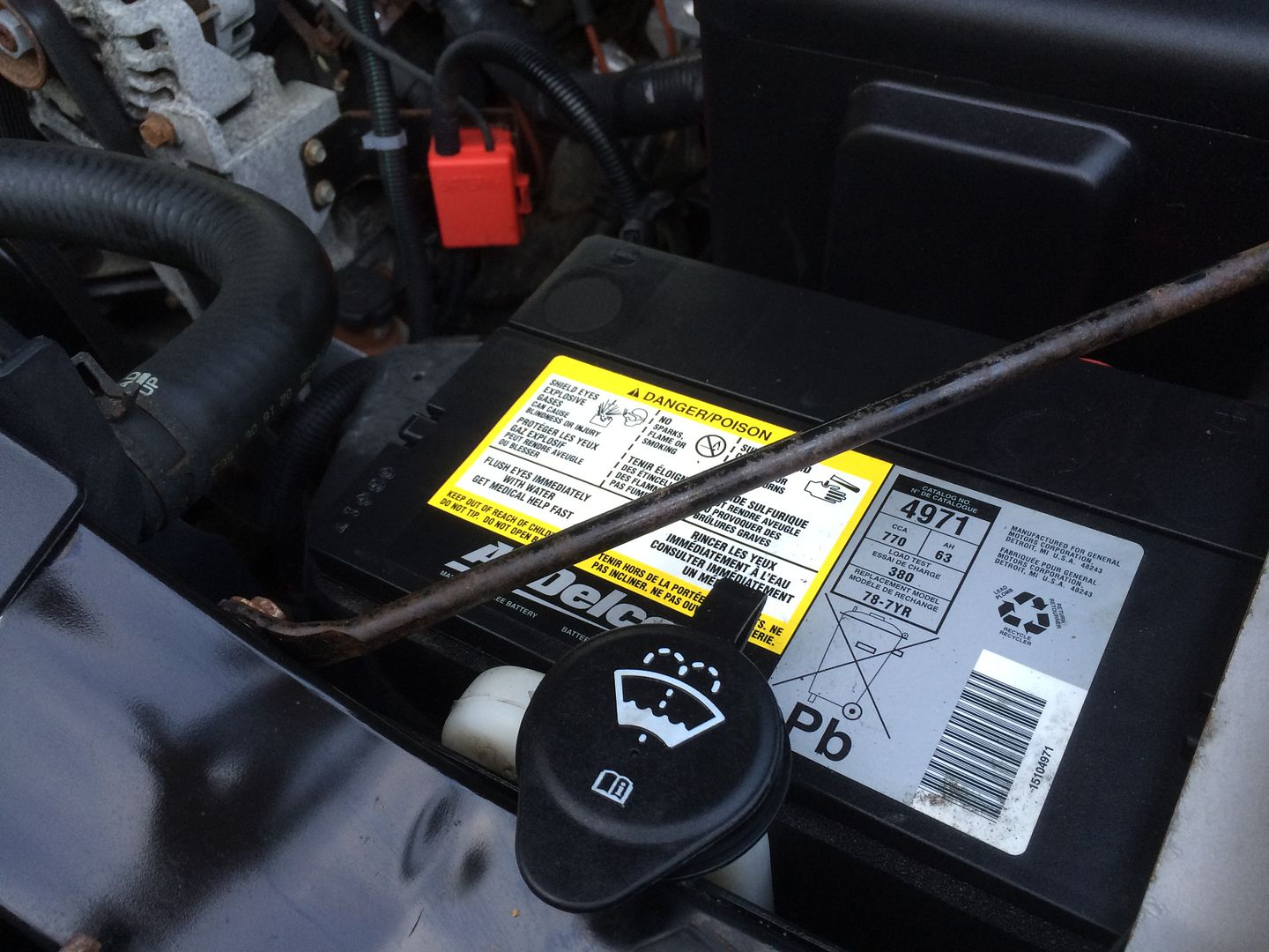

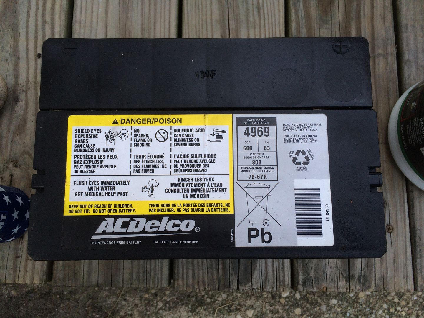

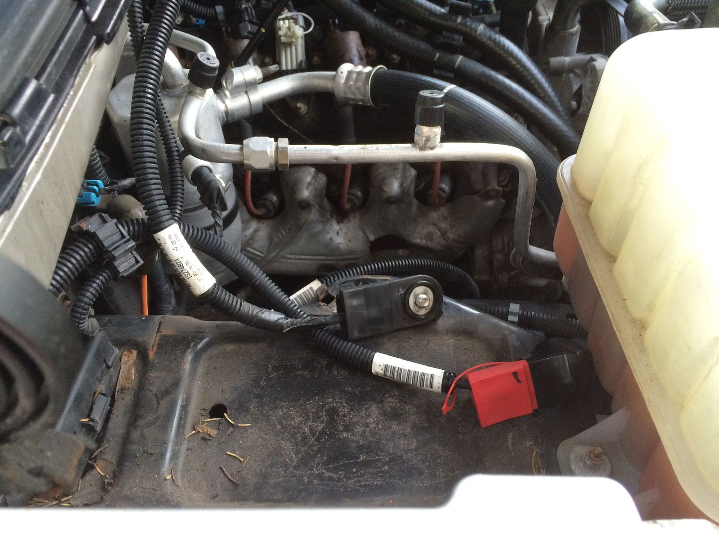

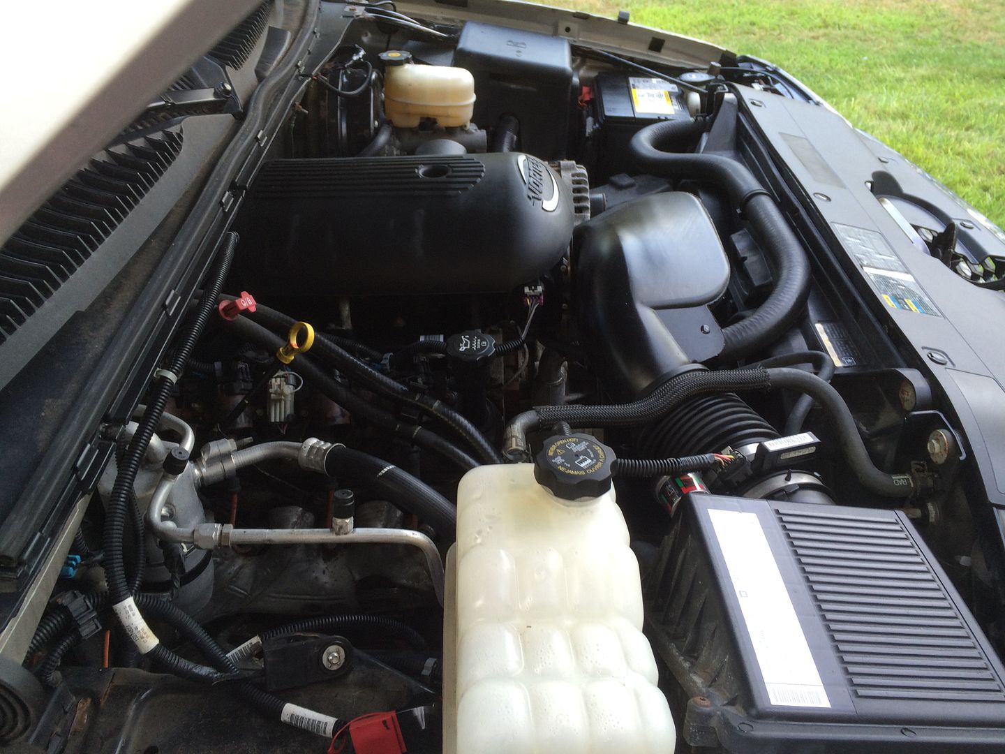

  • Here is tha batt I took out.. And pics of the other batt tray and the starting batt..
    Extra batt
    Starting batt
    Extra batt tray on passenger side truck near firewall.
    Overview..

    Its an 06 silverado 1500 as the pic below shows..
    There is a terminal block that I can hook accessories to..
    Ill take pics and post back in a few...
