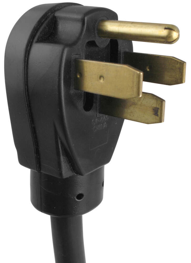

    Surge protector does sort of fit you description...
    Please check the end of your shore power connection. Note the burn marks on this photo. This is NOT what you are suppose to see... Should be clean as shown in the second photo
    Roy Ken
