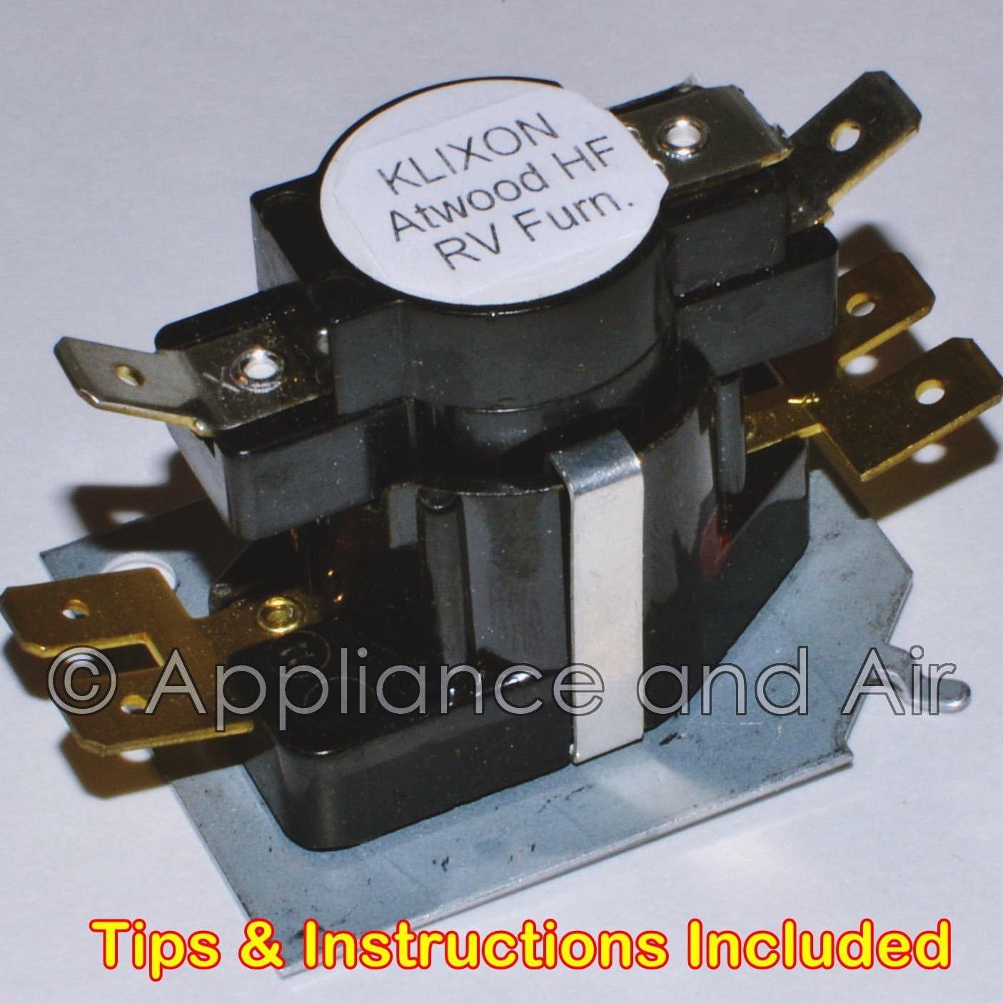

  • Time Delay Relay is a stand alone component on furnace fan cover area
    Red/Blue Wires one side (DC+ from fused source/DC+ to thermostat_
    Red wire on opposite side (DC+ to Fan Motor)
    Blue/White Wires on other terminal (DC+ from thermostat/DC+ to Sail Switch)
    Green Wire on opposite side (Ground to Terminal Block)
    Should look similar to this (Suburban 231202 ---- shop around $50)

    Is the time delay relay on the motherboard, or the circuit board of the thermostat?

    When you get a chance, look closely at the time delay relay. You will be looking for black or blue connection points. Wiggle the wires watching for any movement in the relay.

    Time delay relays seldom fail as they are rated for many thousands of operations. It is about 1 inch black cube.
