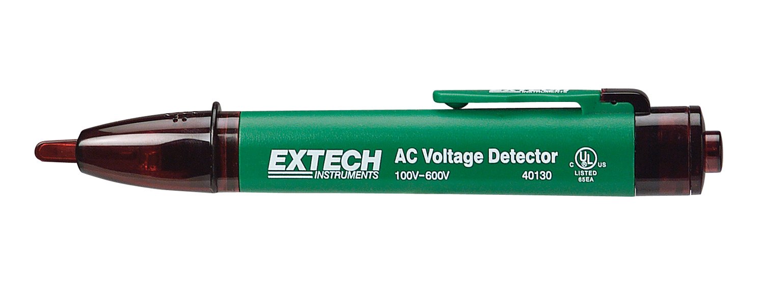

    D.E.Bishop wrote:
    Check out this description on how a proximity voltage detector works.
    According to that article, a DC circuit can not be detected by a proximity tester.

    That is not an AC proximity tester; it is a 12vdc test light like the type that normally use an alligator clip to ground. It actually uses your body as a ground path (hence the metal housing) and will only work if you are touching a grounded section of the vehicle you are testing the circuit on. I built one of these about 15 years ago using plans out of Popular Electronics. It uses a MOSFET transistor as a switch to turn on the bulb/buzzer (hence the battery); Although your body does not have the conductivity to act as a ground for a typical 12vdc circuit, it DOES have enough to act as the ground for the MOSFET.

    The V-trough on the blue tester should touch the wire insulation. The AC proximity tester sometimes is way too sensitive. I wish they were adjustable. For a hoot, with the AC proximity tester, wave it at refrigerator, toaster, microwave. The housing not the connector.
    Some AC proximity testers do have adjustable sensitivity. Mine does via a set of up/down buttons. It is indeed an occasionally handy feature.

    Does this have to pierce the insulation, or is it proximity like this AC tester?
