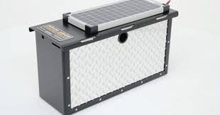

TORKLIFT A-7710RS Battery Box Install
Looking at adding small Extruded Aluminum Vent strips on each side of the two cable holes shown below to give more ventilation for battery gassing. I will be mounting four each batteries in the box
Torklift Image
I will have to cut small slots in the Battery Box wall in-line with the two round cable holes. I will also be mounting a PVC Electrical Box with three 1/2-inch Cable holes on the back side around the two cable cable holes..
Have looked high and low for these kinds of vents with ATTWOOD Venturi Boat Vents. They are however too long. I need something 2-inch wide and 6-7 Inches long. I have found some stamped out stainless steel covers but would rather have the Extruded Aluminum pieces...
