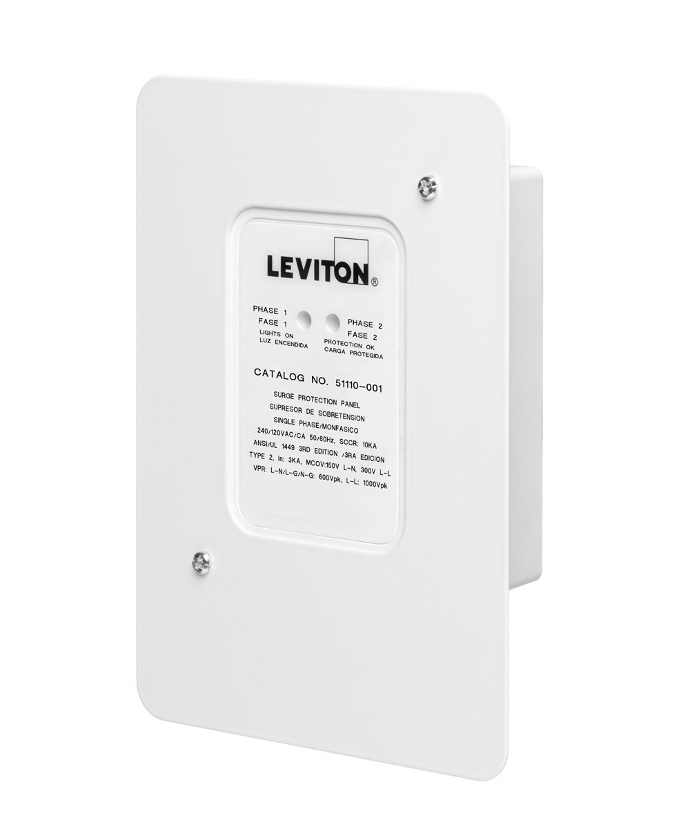

An additional way to add “surge protection” is to install a “whole house” surge protector in your RV breaker panel..
You can get a Leviton 51110-SRG Residential Surge protection Panel for as little as $43 from
HERELooks like
Typical home installation requires the use of two 120V single pole breakers that go to the device.. In a RV you would need only one single pole 20A breaker for a 30A shore power connection and only need to wire L1 or L2 of the protector.. Or if no extra breaker spaces available you could simply wire to any of the breaker protected branch circuits in a pinch.
You can view the installation manual for the Leviton protector
HERE
