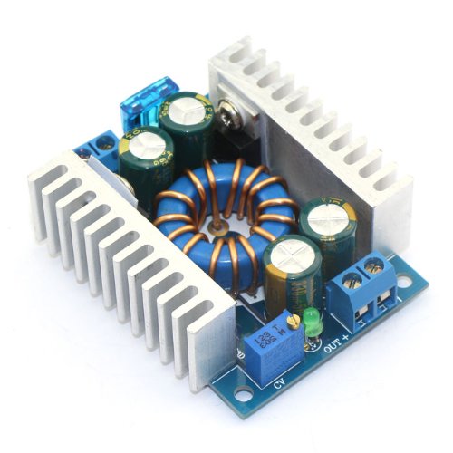

Camp, Forrest, Camp! wrote:
MEXICOWANDERER wrote:
Is this something you leave on all of the time or just periodically to equalize the batteries?
YES! It does have a finite amperage input limit but this is a robust unit. Something that you tweak to get precise control. Exactly 5% of amp hour capacity, and a settable voltage limit of 16.0
It should work well for either float or EQ'ing I would think. It's both cc and cv, and both amps and volts are adjustable. A great find! - Camp__Forrest__Explorer
YES! It does have a finite amperage input limit but this is a robust unit. Something that you tweak to get precise control. Exactly 5% of amp hour capacity, and a settable voltage limit of 16.0 - MEXICOWANDERERExplorerYES! It does have a finite amperage input limit but this is a robust unit. Something that you tweak to get precise control. Exactly 5% of amp hour capacity, and a settable voltage limit of 16.0
- jrnymn7ExplorerThe minimum output voltage is 9v? So no good for EQ'ing individual 6v batts ?
- jrnymn7Explorerso, this unit would offer more voltage range, and adjustable current, and could be powered by a fixed voltage power supply like this? :
http://www.ebay.ca/itm/221290063233
(choose the 12.5a unit)
http://www.ebay.ca/itm/LED-Strip-AC-110V-220V-to-DC-12V-Voltage-Transformer-Switch-Power-Supply-Adapter-/300948401907
(choose 15a unit) - MEXICOWANDERERExplorerCustomize current exactly to ampacity of the bank up to 300 amp hours L-16 time.
Wish I had this gizmo 30 years ago. I pointed out the one in the OP frame because it can handle 600 watts and has an automatic fan control. Adjustable current limiting, no more burning of light bulbs needed. - MrWizardModeratorsimilar product BUT totally different configuration, different MFG
i think landyatch said he was using the DROK brand
DROK voltage booster..amazon
