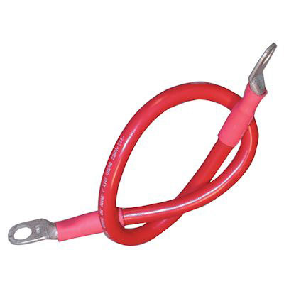

    I am going with 2AWG cables everywhere with my battery upgrade.. My cables will be ANCOR MARINE BRAND cable...
    My cable color is going to RED between the two 6VDC GC2 series batteries and I am going to use RED and BLACK slip-on ADHESIVE SHRINK TUBING to identify the POSITIVE or NEGATIVE TERMINAL connections... These cable lengths will be 6-inch or 12-inch lengths depending what I find available pre-made (AMAZON).
    The ANCOR MARINE GRADE cables has several groups of very fine cables threads making it very easy to work with.
