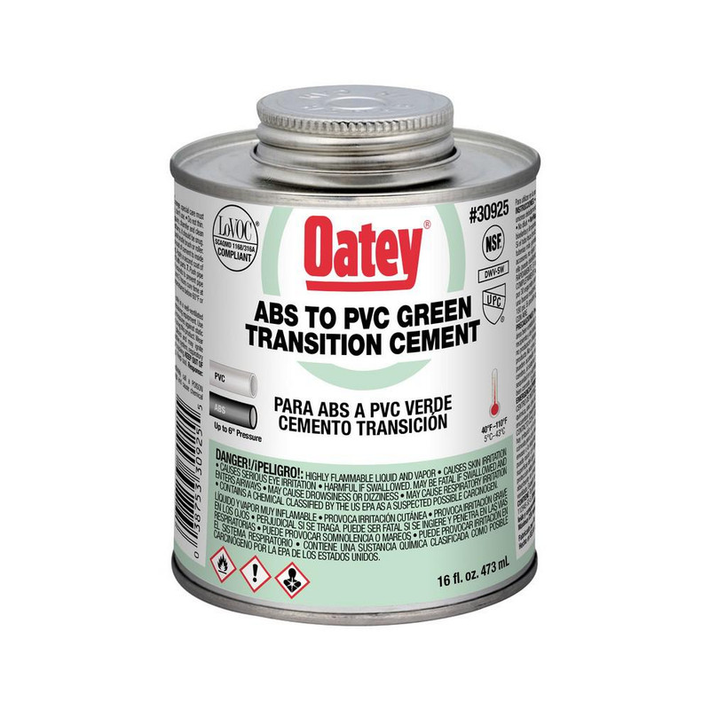

    Just make sure to use the green stuff.
    Oatey Green
    In general I have yet to find a transition glue that works long term.
    I'm not claiming they don't exist, but I have yet to find a transition glue I trust long term.
    I have re-done a few transition joints over the years.
    When transitioning from ABS to PVC I will generally use a mechanical connection like a Fernco or No-Hub coupling.
    Oatey Green
