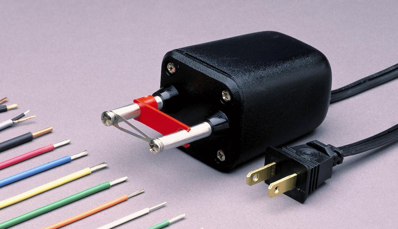

  • How about this:
    https://www.amazon.com/PATCO-Thermal-Wire-Stripper-PTS-10/dp/B00R3R86JU
