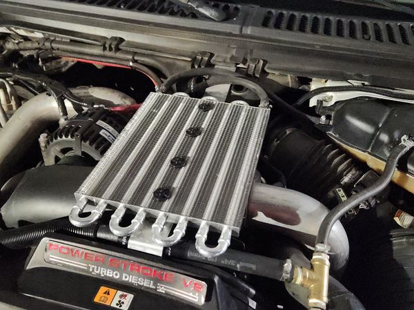

The concept is to cool and condense steam heading for the Degas Bottle, back into liquid to lower pressure, reducing the chance of over pressuring the cooling system, thereby lowering the chance or amount of coolant released by the pressure cap.
So far, the results are to blow a very small amount at 200 degrees under load, going up a long grade.
Previously, before the cooler/condenser, the coolant system would blow coolant starting at 196 - 198 degrees going up a long grade. At 200 plus degrees previously, the coolant would blow all over under the hood.
The headgaskets have not failed in this engine. This is purely a heat, expansion, pressure, cavitation, steam, vapor, issue. The condenser needs to lay flat, level, and able to freely flow steam vapor through the cooler to the Degas Bottle. A different orientation causing pooling or accumulation, would impede the flow of steam vapor through the condenser and impede function.
I believe I'm on the right track to remedy the problem. The next step is to replace the antifreeze coolant with CATERPILLAR Anti Cavitation Coolant.
We shall see if that does the trick...

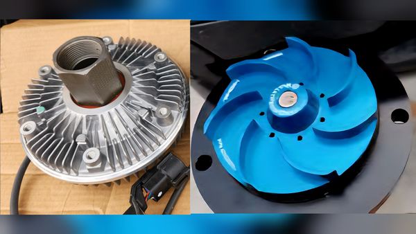

  • Here is a picture inside the waterpump housing.  You can see the obvious shiny area where the old composit impeller was rubbing. If you look closer, you can see the pitting in the metal that is a telltale sign cavitation is happening which clearly it is. Cavitation also happens on cylinder wslls due to engine vibration. Caterpillar engine coolant is designed to minimize cavitation from happening. This condense atop of the engine is there to condense steam vaporization pressure caused by the various sources of cavitation and lower cooling system pressure by condensing steam vapor back into liquid.

      the factory ford stuff should be a anti-cavitiation antifreeze also, they used that even back with the 7.3.  if a modren diesel doesnt have it I would be surprised, or suspect some one who didn't know better changed the antifreeze and put the wrong stuff in it.
      what did the old impeller look like, do you have a side by size comparison of the two impellers?

        I posted a waterpump replacement video a couple months back. I show the old pump and take several measurements of both old and new pumps and impellers.

  • Hope you get this resolved.  I left a note on your tube page about my experience with cavitation caused an aftermarket coolant pump impeller clearance to the housing.
    I see that you have a picture of what looks like the pump impeller.
    Jim

      I did a changing the coolant pump video when I installed the Bulletproof Diesel Waterpump. You could see a couple shiny areas in the pump housing that are probably from cavitation. Diesel engines are also subject to cavitation on cylinder walls. This engine I believe has issues with that cavitation and the resulting increases in pressure due to steam being created. That is what this condensor is an attempt to address. So far, it does actually seen to be making a difference. Far as I can tell, I'm the only person on YouTube, or otherwise going at the issue from the condensation angle. Turning steam vapor back into a liquid state. Steam is greatly expanded liquid,  liquid is greatly condensed steam. Condensing the steam into liquid before being returned to the DeGas bottle seems to be helping.
