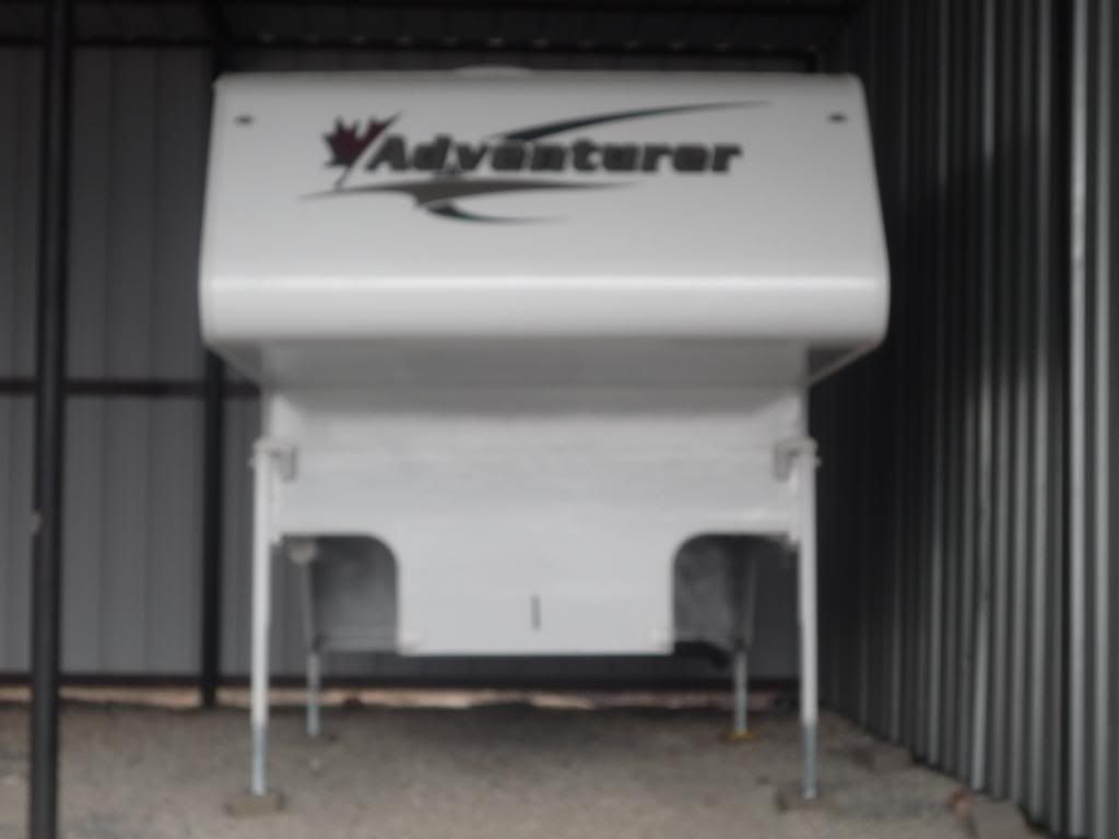

I realize for most of you this is not a big deal but I'll admit I was a little nervous about it the first time, particularly since my floor has some slope. My owners manual is basically useless for this and TC University had an article on loading but nothing on unloading.
So I backed it under the carport, opened the dually jacks, removed the Fastguns, unplugged the cord and lowered the jacks until the rear (which were closest to floor) were just off the floor. Then I placed plywood squares under the rear jacks and 2 2X6's squares under each front jack so that all four jacks were extended about the same length. I then raised it by raising the front a few inches and then the back a few inches while keeping the front a little higher until I could see the truck bed clearly.
After slowly driving the truck out I lowered it repeating the front to back operation while trying to keep the front a little higher until I got ready to do the final leveling.
Questions:
1. Any suggestions on the above process?
2. I could not get the rear closer than 1" side to side level. When I raised the low side enough the other side lost contact with the ground. What's the fix for this?
3. Is there any negative impact on the truck if you leave a heavy TC in the bed for weeks at the time when not in use?
4. Currently I'm not planning on any off truck support for the camper. Is that something I should reconsider?
