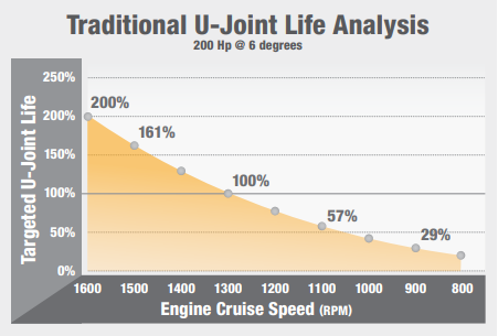

It is not just thinking, it is fact. As I stated before, this was an issue in my industry when the OE's started to adopt "downspeeding" back in the early 2010's which is essentially putting even taller gear ratios on over the road class 8 trucks so that their cruising engine speed is dropped from around 1,400 rpm to around 1,100 rpm. This was all done to meet the upcoming fuel economy standards for class 2B and up vehicles and is likely why we are seeing it done in our trucks since they will also fall into these new standards.
Shortly after this, fleets started to have major driveline issues due to the added stress downspeeding was putting on the drivelines, shortening the lifespan of these components. Clutches and u-joints where all failing a lot sooner than normal. So much so that it led Dana(one of the worlds largest class 8 driveline manufactures) to research the issue.
At first, manufacturers started de-rating the engines, but that still did not fix the issue. Dana had to come up with a whole new driveline system with more robust parts to cope with the added torque stress of downspeeding with these taller axle ratios just to get the component to last as long as they did with the shorter gears sets that were used previously.
If you want to read more on this research and what they did to combat this then you can in this (
LINK)
So I am not basing this on what I "think". I am basing it on what I know and have experienced in my own professional industry. And yes it is a fact that taller axle ratios put more stress on the driveline gear for gear than shorter axle ratios. And yes, I would trust Dana's research(which I have to study and keep up to date with in my profession) over what someone is stating on an internet forum , especially when they are not providing any data or research to back up their theories.
