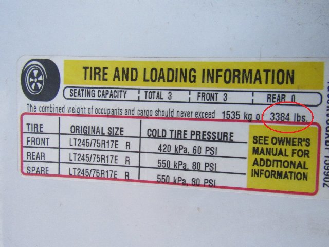

As to camper weight, what does this sticker indicate?
Tell part of the trucks actual load carrying ability. AS others have said a pickup truck carries just about all payload over the trucks rear axle (6100 rawr) which will be around 3000 lbs in most cases. A RAWR is the lessor of the tires/wheels/rear axle assy/rear spring pack. Todays pickups generally the wheels or rear spring pack is the weak link. Years ago it was OEM 16" LT235/85-16 E at 3042 lbs capacity as the suspension weak link.
Another player in the payload arena for the F250 is if it has the heavy service package option. This package upgrades suspension to the same as the F350 SRW trucks.
The F250 won't have any issues carrying a 2155 lb wet weight truck camper you mentioned. - spectaExplorer

- LwiddisNomad III“As to camper weight, what does this sticker indicate?”
Not difficult. The maximum vehicle weight. - RKWExplorer II
