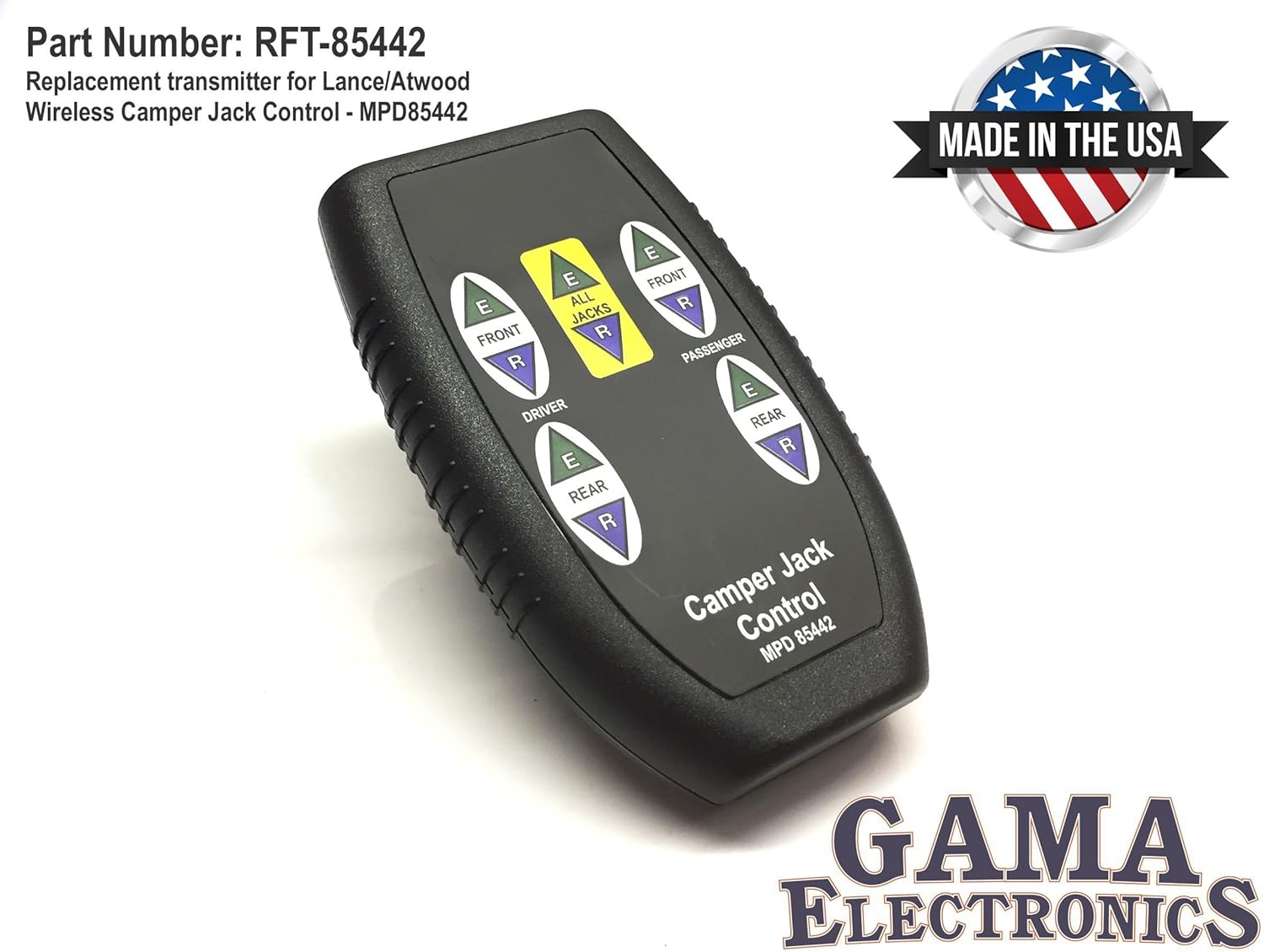

Gama also makes this remote control:

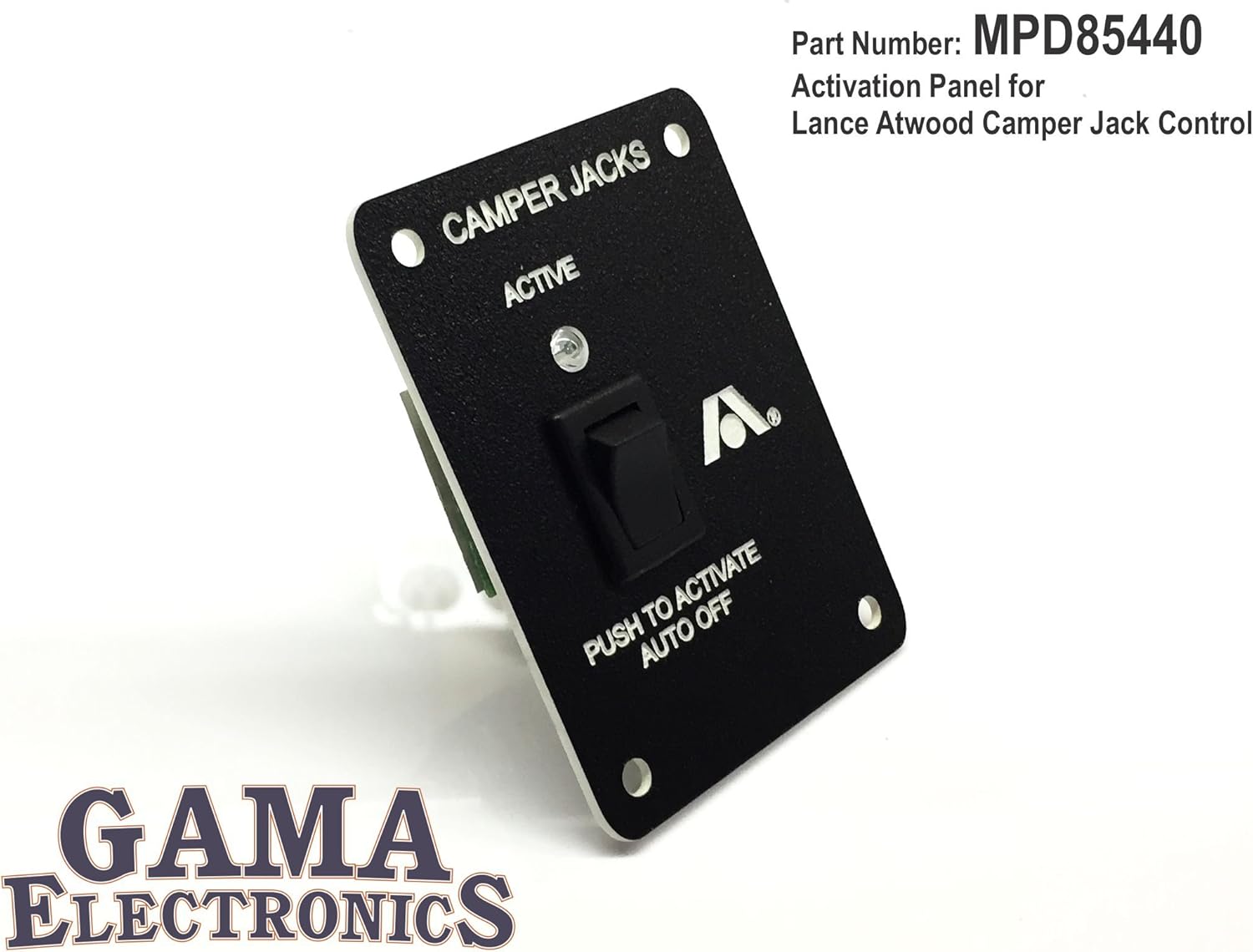

and this activation switch:
I bought all 3 and installed them last weekend. Now every jack works as it should, independently and as a set. I know there are a zillion campers with these jacks installed, so if anybody is looking for reasonably priced electronics, these are worth the $$.

  • Mote wrote:
    Thanks for the information. I may just go ahead and order a replacement remote as the bottoms on ours are getting some age on them.
    Does the remote have to be programmed or does it just work once the batteries are installed ?
    The remote works right out of the box. no programming needed
  • Thanks for the information. I may just go ahead and order a replacement remote as the bottoms on ours are getting some age on them.
