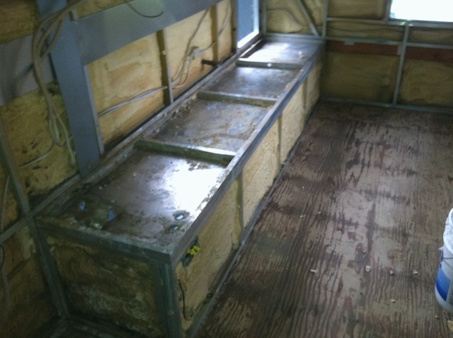

69 Avion wrote:
Does the Barth camper have wood on the bottom?
Here is one guys restoration Blog that is actively rebuilding a 1967 Barth.
1967 Barth Blog
Here is his interior walls, very similar to the Avions...
And here is where the big difference lies between a Barth and an Avion...
It still uses wood in many places, but less than the Avions base.
And this is before he gutted the floor.
Garry - 69_AvionExplorerDoes the Barth camper have wood on the bottom?
