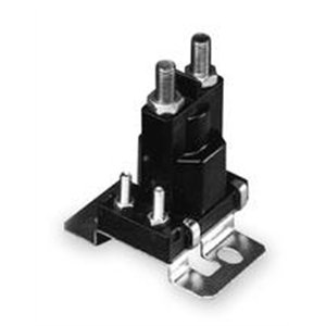

    I got one of these.
    The umbilical cable on my camper comes in right next to the fuse panel. I disconnected the 12V wire that comes from the umbilical from the fuse and connected it to one the top (large) terminals. The second top terminal is connected to the fuse where the 12V wire was originally connected.
    The wire from the umbilical that feeds the running lights is connected to a fuse. I ran a wire from the far side of the fuse (not the side the umbilical is connected to) to one of the small terminals near the bottom of the relay. In the (doubtful) event the coil shorts out, the fuse will blow, protecting the truck. Then take the other terminal on the relay to the - side of the 12 volt system.

  • portscanner wrote:
    As you discovered, Dodge does not turn off 12V feed (some manufacturers do.) As I did not want to give Dodge an excuse of "you modified the truck - your warranty is void" I found the 12v wire from the pigtail inside the camper and installed a relay to isolate it. I tied the relay coil to the running lights in the camper.
    Start the truck - running lights come on - 12V is tied in by the relay. Turn off the truck - running lights turn off - 12V is isolated.
    If you want, I can dig up the info on the relay. I got it off Amazon. Took me all of 15 minutes to install it. Never have to worry about leaving switch on and killing the batteries in the truck
