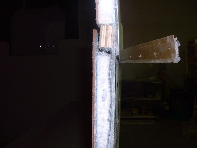

... But more to the point: the joint on a Bigfoot and the copies is constructed by overlapping the top shell outside of the bottom shell. Then a piece of decorative trip is placed on top of the overlap and screws driven though to hold the two together. The overlapping seam is by its nature leak proof - or would be until they drilled a bunch of holes through it.
The photo is from a Northern Lite, but the construction is the same on the Bigfoot.

But more to the point: the joint on a Bigfoot and the copies is constructed by overlapping the top shell outside of the bottom shell. Then a piece of decorative trip is placed on top of the overlap and screws driven though to hold the two together. The overlapping seam is by its nature leak proof - or would be until they drilled a bunch of holes through it. Many people (including the factory!) insist on smearing silicone at the edges of the decorative trim to give it the 'appearance' of being sealed. This does little or nothing to seal the joint, and may actually have the effect of creating leaks: if the top fails and the bottom holds, you now have a rain catchment directing water at the screw holes, which is the vulnerable point.
If you wish to seal it, or are having problems with leaks at the joint, I would remove the vinyl trim strip in the decorative trim (it just peels out), remove the screws one at a time, put polyurethane sealant on the threads, and reinstall. This will seal both the threads and the head, and is as good as you can do without a lot of work. If it is an older Bigfoot the screws will be cad plated and will have rusted, now would be a good time to replace them with stainless steel (which newer ones will already have). If the vinyl trim is past its 'best by' date it is a standard item at RV stores.
